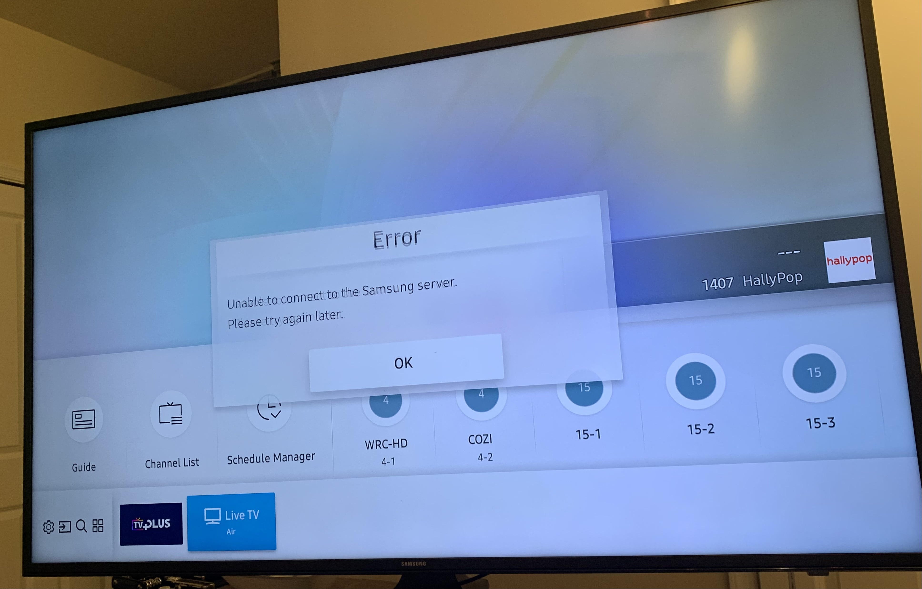

#1 Connection Error. TV is in Plus Live TV (app?). Cannot press 'OK' though select button is working. No inputs work on this screen work except for back button, bringing me to screen in next pic, and the other buttons above)

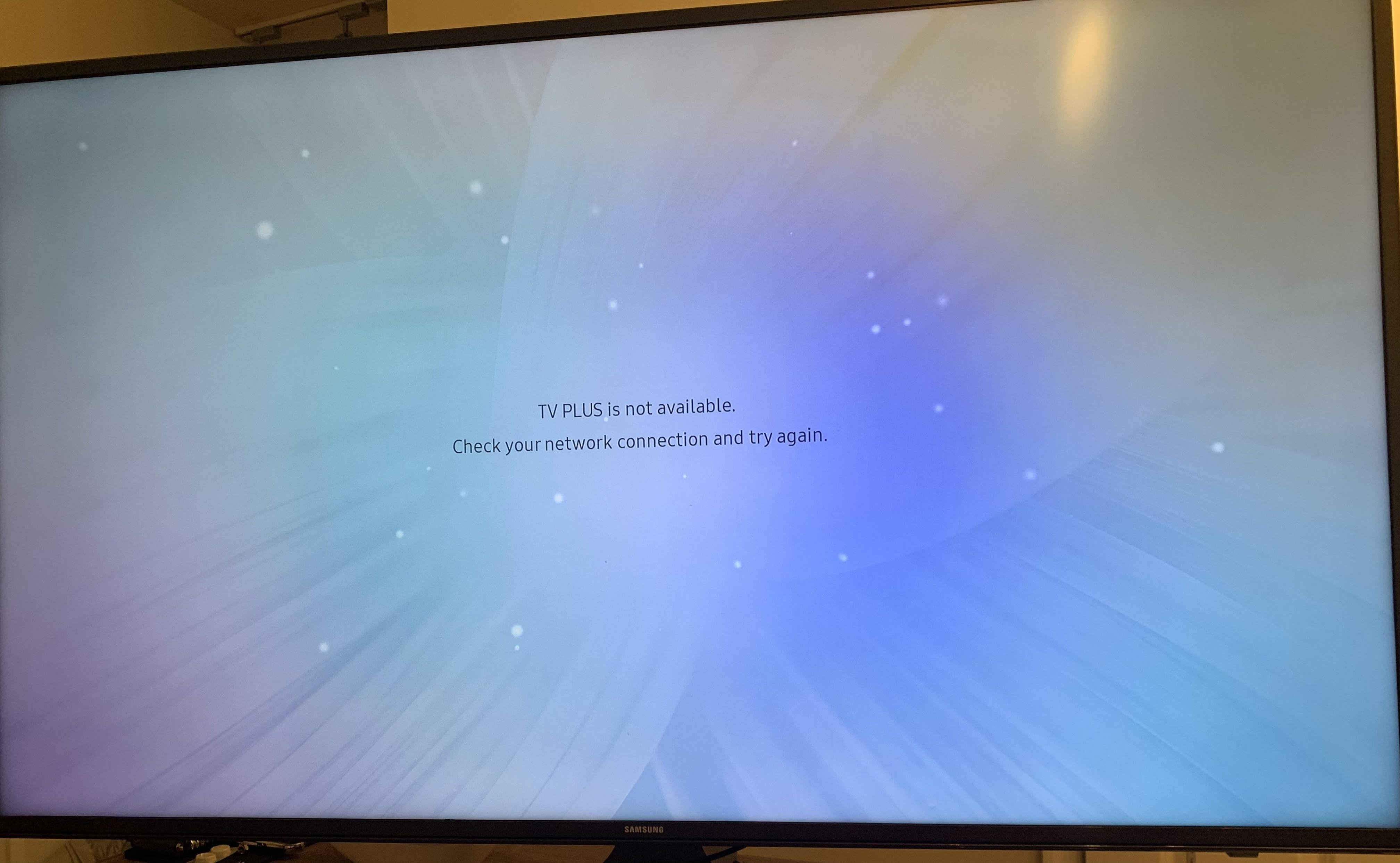

#2: Live TV screen. Only the back button, which brings me to screen #3, and the above-noted buttons (that're useless on this screen) work here

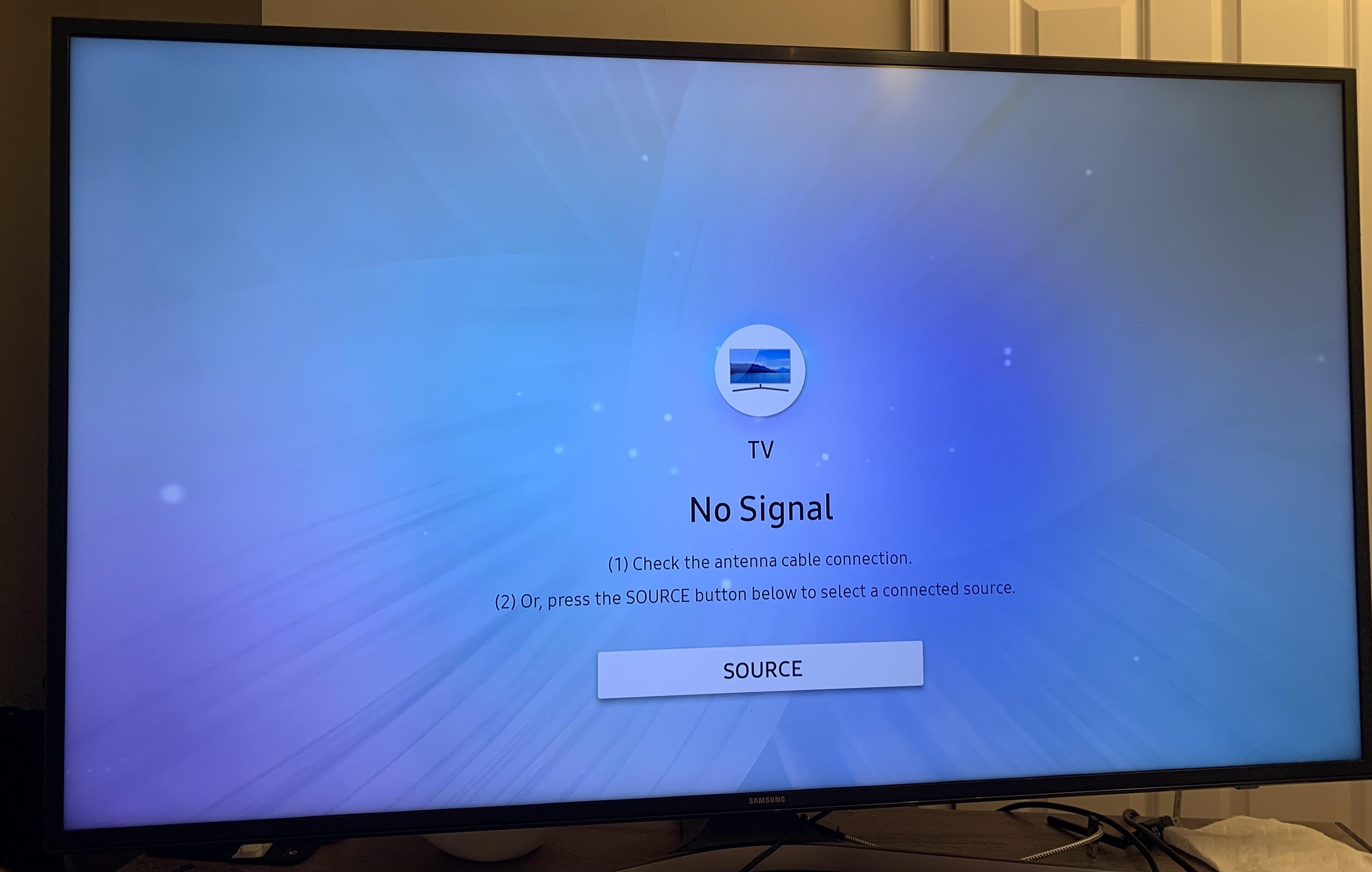

#3 No Signal/Select Source.  Selection of SOURCE icon is registered, gets 'pressed down' on screen and plays a noise, but nothing happens, even with HDMI connected (I tried 2 functioning cables on both non-ARC ports). Pressing back brings me to #2. Reboot is needed to get Screen #1.

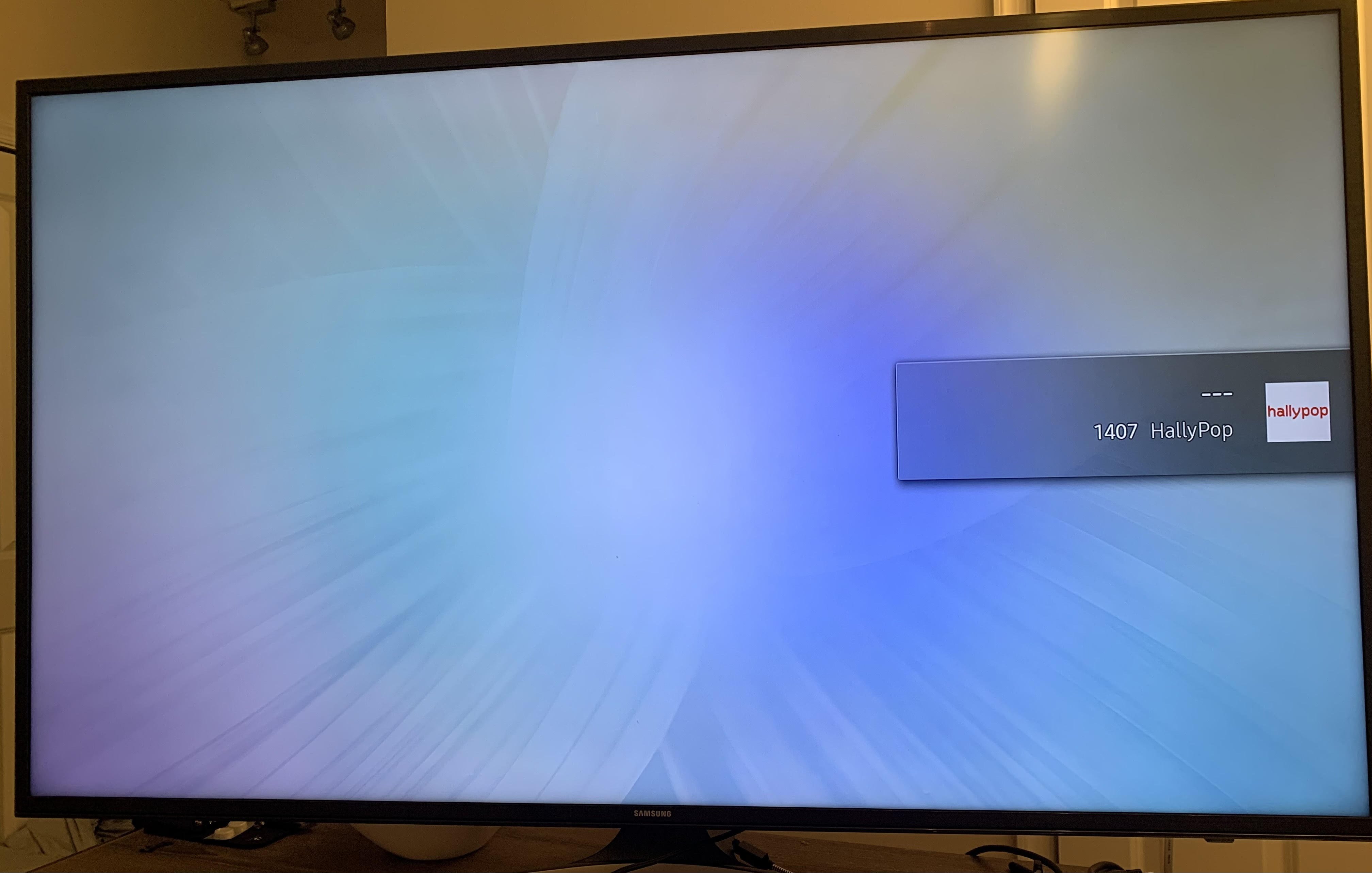

#4 - like #3, but from pressing Esc on keyboard. Not sure why the difference.
